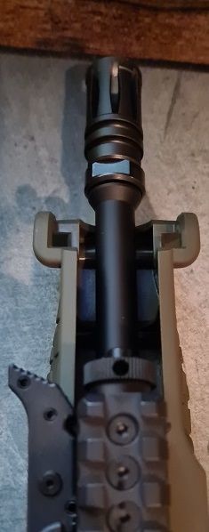

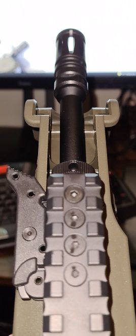

Hi, I was wondering if anyone has the mk18. I just changed the hop chamber to to silent industries mtw alpha and their v2 nozzle, problem is it won't feed. I think the mags are feeding, the problem is with the unit or bucking. Just wondering if anyone has experienced this and could give me some guidance.
This can be many issues that you are facing or it could be very simple. ive fitted a few of these units into MTW and AEG/ HPA rifs..
What hop rubber and barrel did you got for? I normally go for the G&G Green or ASG Shark (RED).
Which Tensioner did you fit with it?
Did you do a BB test before fitting the unit into the RIF?
