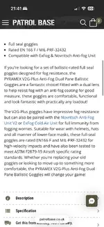

In the UK it is a matter of buyer beware, but Patrolbase are selling those goggles for Airsoft.
They do have a rating for impact protection so are a form of eye protection.
But as I stated they have used marketing words to state protection standards. They quote the combined standard of the goggles at a lower level than Airsoft guns shoot at.
An uninformed new player can read that and think that the product is fully suitable
As I and @Lyndication have stated we do not feel that they are suitable
It is true that the different components can meet different standards, but the combined goggle system then only meets the lowest of those standards

As there isn’t an accepted standard for Airsoft then you can argue for those that meet any of the standards but with the claim that the Pyramix meet MIL-PRF-32432 it is in contradiction to the lens being EN166B and the frame EN166F. The product data sheet clarifies EN166 for the lens and the frame but does not clarify MIL.
A MIL standard frame includes holding the lens. Therefore an EN166F frame cannot hold the lens to MIL-PRF-32432 standards
