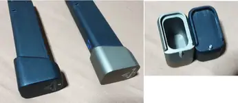

I could not find much if any info so I thought I would start a thread.
Boom Arms Ramjet made for VFC will fit with some fettling.
Mag bases made for VFC will work but unlike the Samoon ones they are hollow. I glued the spring guide in otherwise when filling with BBs it would ping into the mag base. Filling the base with something might also do the trick.
Sights made for VFC will fit. Front was a screw in fit rear needed a hammer. Both slide and sight are steel, I am not sure a weaker metal would would take it.
The V2 upgrade kit that comes standard with the 45 is 100% worth the upgrade (even though I think it should have been free) it removers the flicker, drops the trigger weight (got a tester incoming) and in combination with the new valve increased the power. Add a longer grub screw to the 4UAD trigger and you can remove all of the take up if you want to due to the flicker and bar not be present in the trigger locking block.
If you have any more info on parts compatibility or performance tweaks in general would love to hear them.
