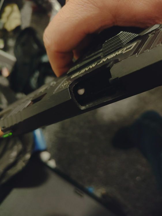

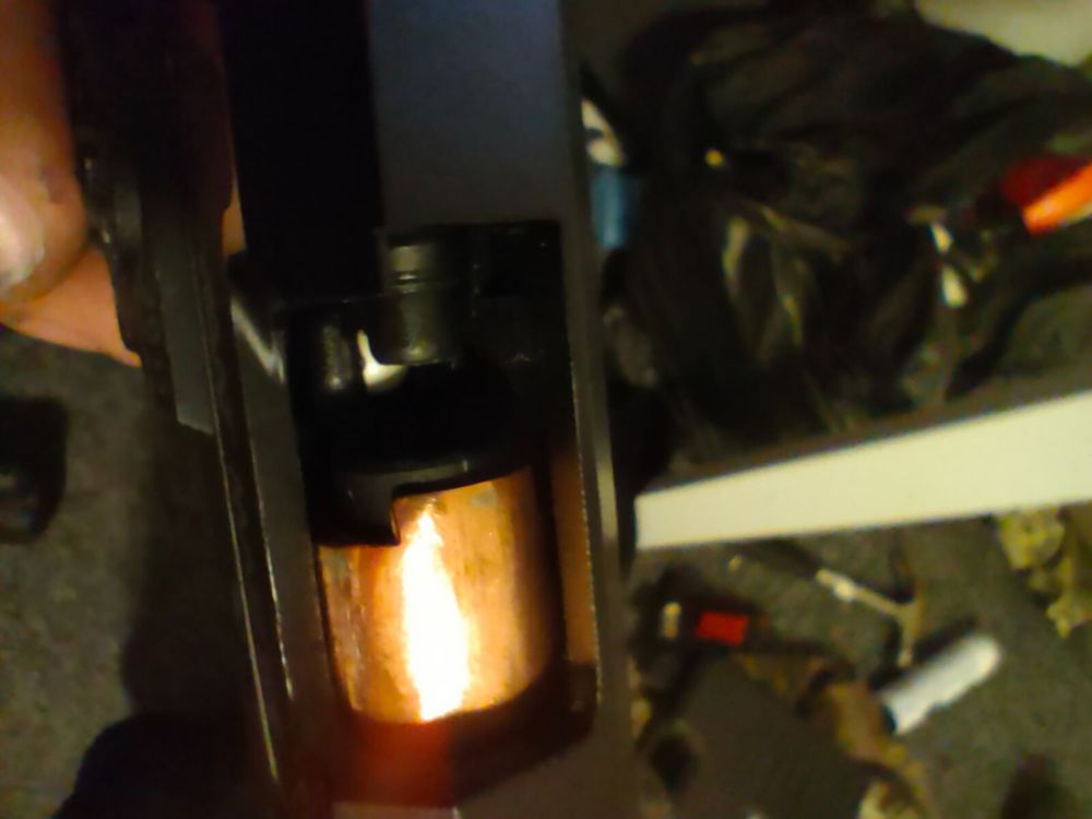

I've got an asg combat master c02, and it's not feeding right.
Mags are fine, and when I slowly move the slide I can see the nozzle is pushing the bbs down instead of into the chamber. I can chamber a round if I push the slide closed hard, but when firing it tends to not feed.
Anyone have any ideas what could be wrong before I take the slide off and start fiddling?
Here's some pictures to show what I mean. Videos are too big to post unfortunately.

Have you taken off the slide and had a look at the nozzle to check for damage ? otherwise is the mag sitting fully home ?

No damage, but it loads fine if I take off the flared magwell or the bottoms of the mags. Guess I'll have to file down the bottoms of the mags.

However, I did glue a thin piece of Warhammer to the bottom of the loading piece of the nozzle to test the theory. I had to file it down even thinner, but it worked!
Until the super glue gave out.
I now know that it's definitely the loading nozzle being too high, I just need to figure out how to bring it lower or find a better way to glue the plastic piece to the nozzle.

I've reglued a piece of plastic, but this time I scored both the loading nozzle and the piece of plastic first to give it a better surface to glue. It seems to be holding so far, and feeds a BB every time with both the magwell and baseplates on. I'll probably redo it at some point with some epoxy adhesive, but this will hopefully work for tomorrow's day at Tud. Thank you everyone, I really didn't want to have to get another pistol yet.
