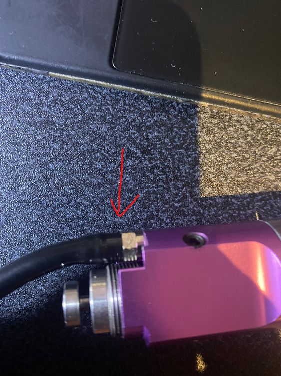

So far I’ve removed the line from the engine and tried to push the tubing towards the nut. This stopped air leaks to start with, but when I bend the tubing to run it through the pistol grip it starts to leak again.5FD9796E-AD84-46A4-82EE-AA1502B38CFD.thumb.jpeg.a70a52c8ecb90bba49eb2c92102ca20c.jpeg
It’s most likely ‘just’ the hose was originally slipped onto a nipple whilst warm and when cooled
There should not be air getting all the way up the ‘ribbed nipple’ to arrive at the arrow mark
There won’t be much to be done other than cutting the hose shorter and making another connection - which is bound to be too short and also less likely to get a good seal

If it’s not new then consider buying a replacement hose or if confident about constructing a replacement hose
A potential bodge is to ‘aid it’ with some heat shrink
Cover the joint as well as you can, then warm the hose in warm water.
Press it forward and then cool it
(The hope here is to get back to the best seal)
Make sure it’s fully dried
Get some heat shrink, long enough to go back up the hose and onto the fitting - but not so far enough to effect the join
Gently warm the heat shrink evenly
Note that you’re trying to hold your original hose well rather than gaining any extra seal, but the shrink helping to hold in place as you guide the hose around your RIF
