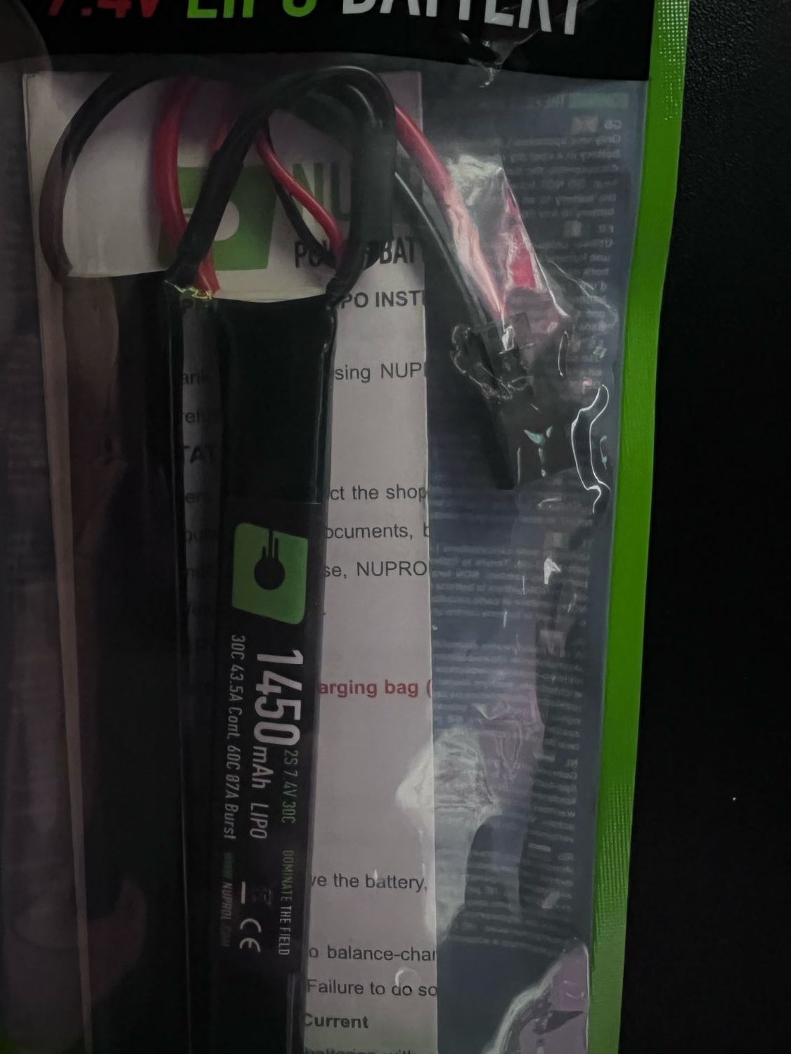

Your settings for this battery will be:
LiPo Balance Charge
1.4A
7.4v (2S)
Your battery has a mini-tamiya Connector - which won't work with this charger unless you buy an adapter.
Once you receive said adapter, you will need to de-pin the wires on the mini-tamiya end (using a pin or the inside of a biro inner ink tube) and swap them over, reversing polarity for Airsoft use.
Once reversed, plug the yellow end into the yellow socket on the charger, connect the battery to the adapter's mini-tamiya connector, and the balance lead on the battery into the balance port on the charger.
Start charging and away you go. The charger will beep when it's finished, generally around an hour depending on how good the balance logic is and the condition of your LiPo's cells.
