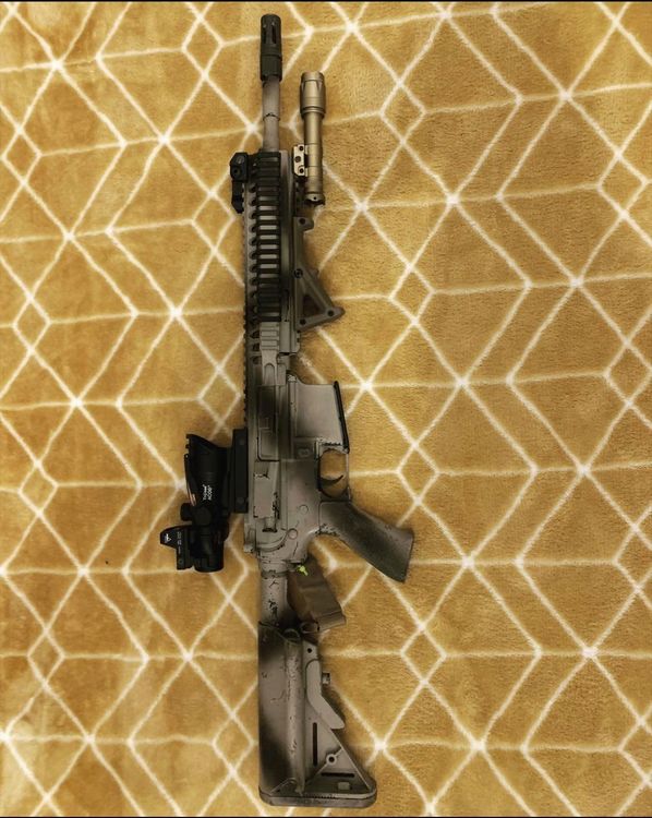

This is one of my rifles, 4 years after being painted with Halfords paint. It’s worn but in general still looking good.
Having spent large portions of my life painting surfaces, I’d say prep it every time. Yeah it might take a bit of work but the results will always be worth it.
