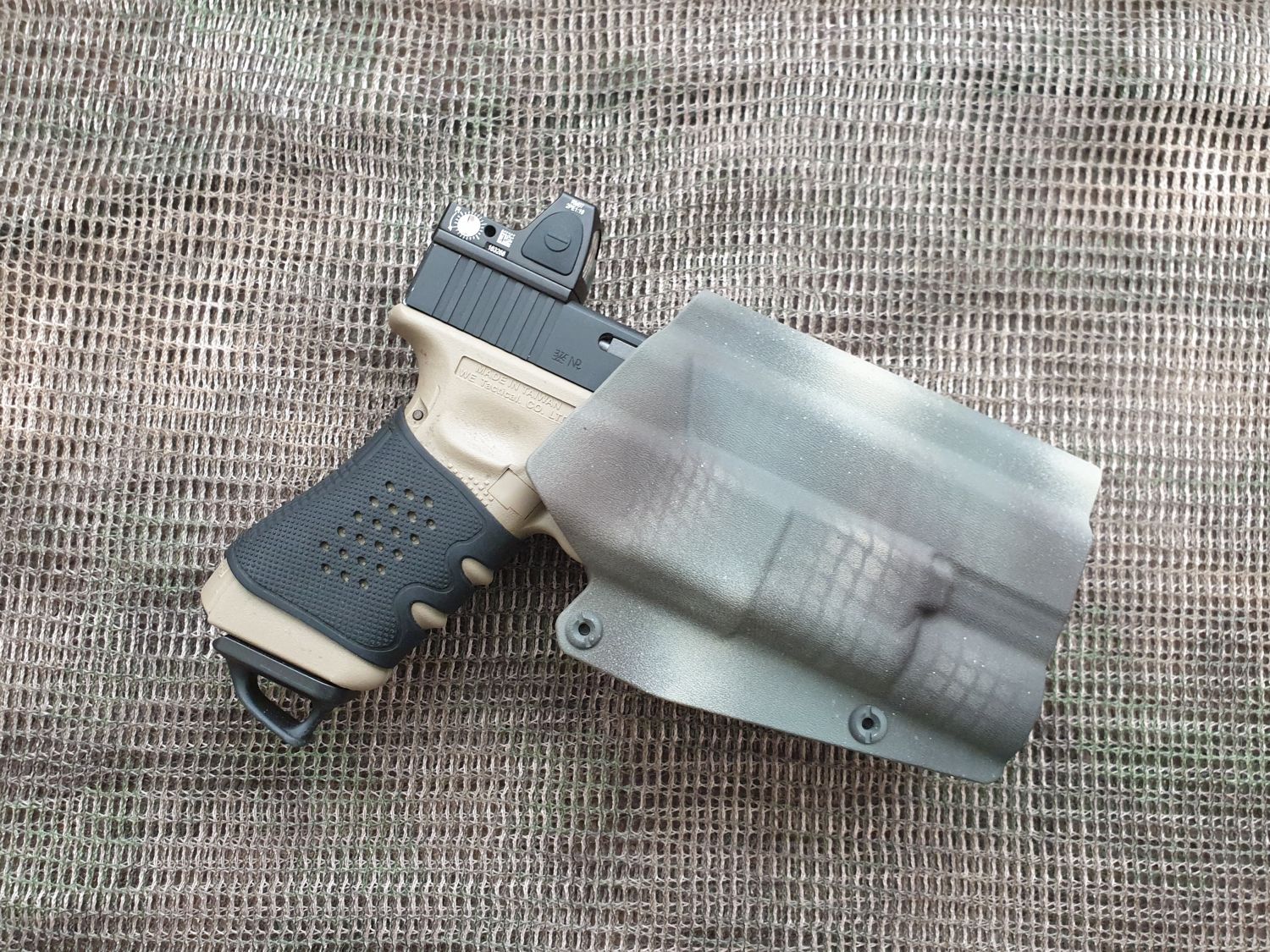

What type of  ' retention holster' fits a TM G17 with torch nicely as i need to upgrade.
I had an original IMI paddle retention type one as i got it on a deal so was cheaper than the 'clones' but they are tight and i had to file it away to get the G17 to fit.... someone mentioned before getting one to fit a G22 as its slightly bigger and fits the TM 17 better?
what are the We/Nuprol/other brands like fit wise?
It will depemd what torch.
I picked up an FMA G17L holster and will be trying it out this weekend.  I use a we glock 17 and have fitted a surefire x300 replica. IMG_20200810_173846_032.thumb.jpg.3badcacd2e0441f59440f0213bf0f993.jpg
